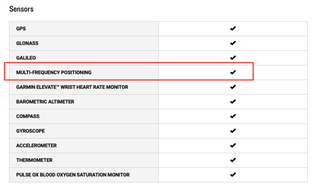

So what exactly is this "MULTI-FREQUENCY POSITIONING" that Garmin has listed for the F7?
Is that dual band or just using all available systems in single mode?

fyi, Garmin's product announcement at the top of this forum specifically says this feature is on Sapphire Editions only

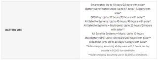

I read again Garmin site and it's strange, that this MULTI-FREQUENCY POSITIONING item is not on previous models. So it shouldn't mean combination of GPS systems. Maybe this is really L1+L5 dual band and they measured battery consumption with multi band only on top models. But this is my assumption. We will see it, when somebody has F7 in hands.
