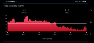

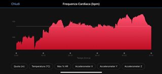

Hi everybody,
i tried again in 2 different watch:
fenix 5x plus:
fenix 6x plus:
fenix 6x plus is the worst case! HR sensor stop to respond just 4 minutes after the begin of the activity. Fenix 5x plus did better... worked for 15 minutes and then HR samples stucked at 130/140 bpm. Then moving the watch and changing some setting begin to work normally... i'm depressed...
