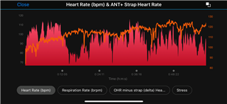

    Today I tried it during a 63 minute indoor bike ride. For the first 30 (ish) minutes I was riding on the hoods, as usual, but the data from the OHR did not look too clever, so I sat up and left my arms and hands loose and free, with no gripping of anything. This did not improve results at all and towards the end of the ride the OHR went really quite nuts compared to the steady data from my TickR chest strap.
    Overall HR stats were....
    OHR average = 141 BPM, TickR average = 154
    OHR max = 174, TickR max = 189
    The screen print below shows OHR trace above and TickR HR + power data below. You can see the relationship between power and TickR quite nicely. Just what the OHR is doing is anybody's guess. At times it can be very close, but the gulf between values can just as easily be vast. I have added this result to my ticket with Garmin Support.
