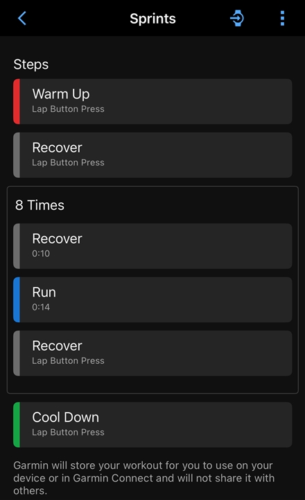

I sometimes do outdoor sprint sessions where I program a workout in advance that looks like this:
I.e.: run to the place where I want to sprint. Get my breath back and then - crucially - have a 10 second countdown before every sprint, because I don’t want to start with my hand on the lap button. Recover after every sprint while jogging back to start, and then new countdown.
