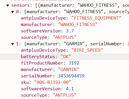

From what I see in the activity data, the watch was connected to two sensors - the Garmin Speed Sensor 2, and some unspecified Wahoo sensor. I suspect that it is the Wahoo sensor that injects the 0 W power…
Thanks for the deep dive into the data! I belive you're absolutely right! I could not see the second sensor (Wahoo) in my activity but for some reason it added itself(?) and overruled the power data..…

From what I see in the activity data, the watch was connected to two sensors - the Garmin Speed Sensor 2, and some unspecified Wahoo sensor. I suspect that it is the Wahoo sensor that injects the 0 W power into the activity. And, of course, zero watts of power result in zero active Calories.
If you do not need the Wahoo sensor for something, I recommend disconnecting it.
PS: The HR screenshot is no more necessary, I am rather confident the Wahoo sensor is the culprit
Thanks for the deep dive into the data! I belive you're absolutely right! I could not see the second sensor (Wahoo) in my activity but for some reason it added itself(?) and overruled the power data...? Anyhow, I tried again yesterday and activly removed the Wahoo sensor and, voila! The active calories are back!
