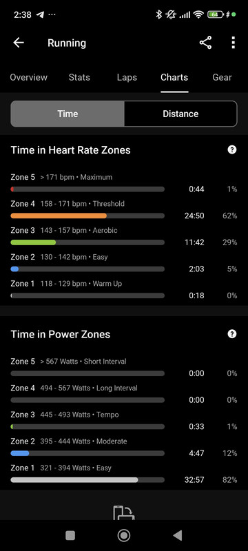

I'm using the Epix Pro Gen2 with a chest strap and I'm wondering why, during a very intensive run for me, I spent 82% of the time in the Power Zone 1 "Easy".
My HR is in Zone 4.
Garmin automatically measures watts. I just don't know if and how the watch determines a kind of FTP (Functional Threshold Power) or if I should generally disable watt measurement while running.

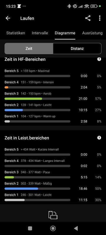

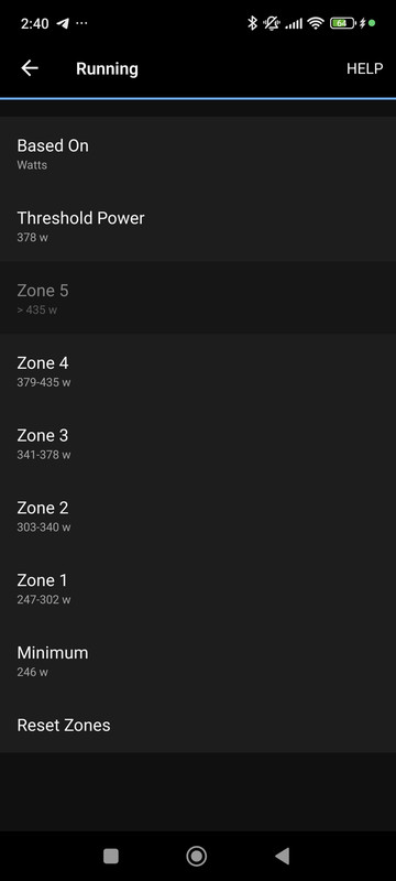

  • Thank you for the many responses. I have now switched to "based on Thretholt Power" in the power settings. Now it seems to be roughly correct, and the rest will adjust automatically as I run more, since Garmin's TP is automatically adjusted. Previously, I had watts (first post) here.
