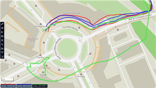

  • hi, i saw something strange on a regular run course for me, i will verify this ASAP.
    i confirmed that GNSS Fix was green before starting.
    green course is the latest with 20.22 and the others (blue and red) with 19.xx. i have check many other activities since 2-3 years and this is the first time i encounter this issue.
