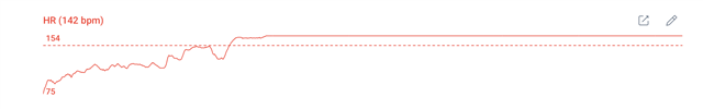

I have an issue with the heart rate becoming fixed on a fixed value part way through the run. It works fine for a while (today, about 25 mins), then locks onto a particular heart rate (today it was 154) and it stays on that heart rate for the rest of the run. See below for the HR graph from Garmin Connect. On other days, it will lock onto a different HR value.

Also, is it possible to exclude the HR from this run in the metrics - this run looks like I did an hour V02 max workout…
