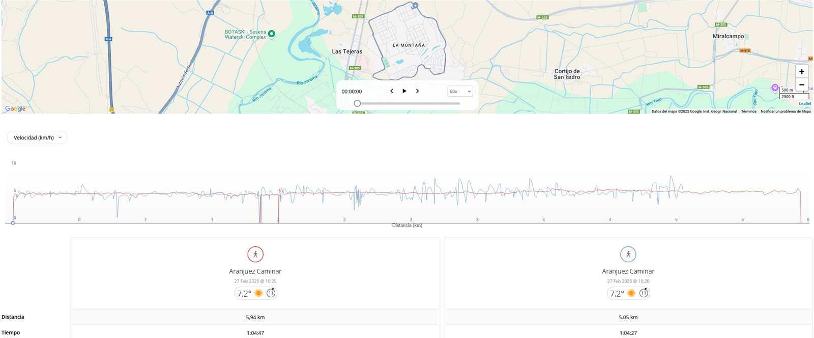

I have a problem with my epix 2 pro. It measures the distance traveled incorrectly, but this only happens during walking and hiking activities.
I compare it with my wife's fenix 8 and it always shows me about 100-200 meters less for each kilometer. On some 5 or 6 kilometer routes I lose 1 km.
I have tried to compare both routes, and you can see how the speed of my epix changes suddenly and makes strange waves, as you can see in the capture.
Could it be a problem with the accelerometer? Since the distance measurement works perfectly during running activities, because I suppose the GPS is used more than during walking activities.
I have already tried to reset the watch to factory settings several times, use the data recording per second, use the multiband GPS, etc.
