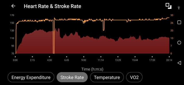

  • How does this make sense?
    It's a workout I just completed on a Concept 2 rowing machine. Notice the shart drop in HR at about 5:50, from 129 to 110. No explanation. It continues fluctuating 110-117 (way too low!) until, near the end as my stroke rate (effort) increases, HR drops further. A minute after finishing, I did a manual 10-second HR check. It was still over 120, meaning during the workout is was probably above 140, as I would expect.
    Data like this is useless.
    I await the usual comments that I'm wearing the watch wrong, or all wrist OHR sensors are just as bad (they aren't) and I should buy a chest monitor, or the best of all, Garmin HR sensors are simply too accurate and thus can't be expected to be accurate (still trying to warp my head around that one). Oddly, for the apologists, my earlier Vivoactive 3 and Fenix 6 Pro never had this problem (and yes, I've checked past data).
