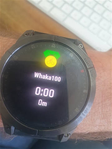

I am in week 8 of 16 for a Garmin Cycle Coach plan, linked to an upcoming race on Oct 27 (Whaka100).  Last night my watch stopped showing any suggested workouts for the race, and there appears to be a problem with the plan and/or the attached race. On Garmin Connect Web the plan is still active, says week 8 of 16 and all the details are correct. The Workout Schedule shows bike icons for rest of this week (6 days), but clicking on to the schedule to see the workouts just loads a blank page.   The plan also looks correct on Connect App, but the Workout Schedule is completely blank for every week in the future (and the past).  Tapping on "Plan Overview" in the Connect App crashes the app and goes back to the app home screen/dashboard.  The race shows up correctly in Connect (web and app) and all the details are correct.
On the watch, the Primary race glance now says "No Race".  The Race Calendar glance does show the race, but it only displays the name and 0:00. Selecting the race from the race calendar glance just shows a gold trophy with time 0:00 and distance 0km, as if it has finished. See screen shots. From the Garmin Coach glance on the watch, all daily suggestions for the upcoming week are for running (!).
I can't tell whether it's a problem with the coaching plan that is affecting the race event, or the other way around. Or both.  Either way, I can't see any way that might sort it out other than deleting the race (which will also end the coach plan) and re-creating it. But then I will lose the 8 weeks of training data, which was the entire base phase and the start of the build phase - and the new plan will presumably start with a new shortened base phase, or may not even create at all as I am now less than 8 weeks from the race.  I would really like to avoid this outcome.

  • I needed to get something going again asap, so I gave in and deleted the race event, which ended the Garmin Coach plan.  Then I created a new event and a new cycle coach plan, and I am back up and running again.  Fortunately, it has not had a significant overall effect on the plan schedule.  The new plan has just given me one week of Base training, before going straight back into the Build phase (which I had just started on the old plan), and the intensities look similar to those I was expecting this week from the old plan.  I may just be lucky based on the timing of the event, and the stage of the plan I was in, but certainly in this case it ended up not being a big deal.
    Of course, I am just a mediocre but enthusiastic cyclist, so the minor disruption to the training plan will likely have exactly zero effect on my performance in the upcoming race Laughing but I could see this being a much bigger issue for a competitive or professional athlete.  If you believe all the marketing hype, then these are exactly Garmin's target audience for their high-end watches (965, Epix, Fenix, Mars) etc.  I would argue that a professional athlete is surely not using Garmin coaching plans - they would have their own personal team of experts - but it is easy to see there is a conflict somewhere.  If the Epix is, indeed, targeting serious athletes then the "serious" features that it is pushing should be flawless.  Especially since these are the very features that separate it from mid-tier devices such as the Forerunner 265, and also the main competitors.  My wife has a 265, and unless you are a serious athlete, the only difference you would notice is the cosmetic look of the case.  And of course the 265 has the new-style UI that is not coming to the Epix Wink.
    Anyway, I am sure the issue for me was that the race date was corrupt somewhere in the bowels of the event definition.  All the symptoms pointed to the watch (and Garmin Connect) thinking that the race had taken place on Sunday 1 Sep (exactly 8 weeks early), but the coach plan was correctly expecting to run for another 8 weeks and didn't know what to do with itself.    I doubt that is going to help anyone else in the future but at least I have a likely explanation for what went wrong.

  • I spoke too soon.  Woke up this morning to find that the plan had crapped out again.  Watch showing the same Medal with a 0:00 for the race, and no more Cycle Coach workouts scheduled, either in Connect or on the watch.  It's a joke really.  I would have to say based on my experience that the Cycle Coach adaptive plan simply is not fit for purpose.  I highly recommend *not* relying on it for any serious training.
