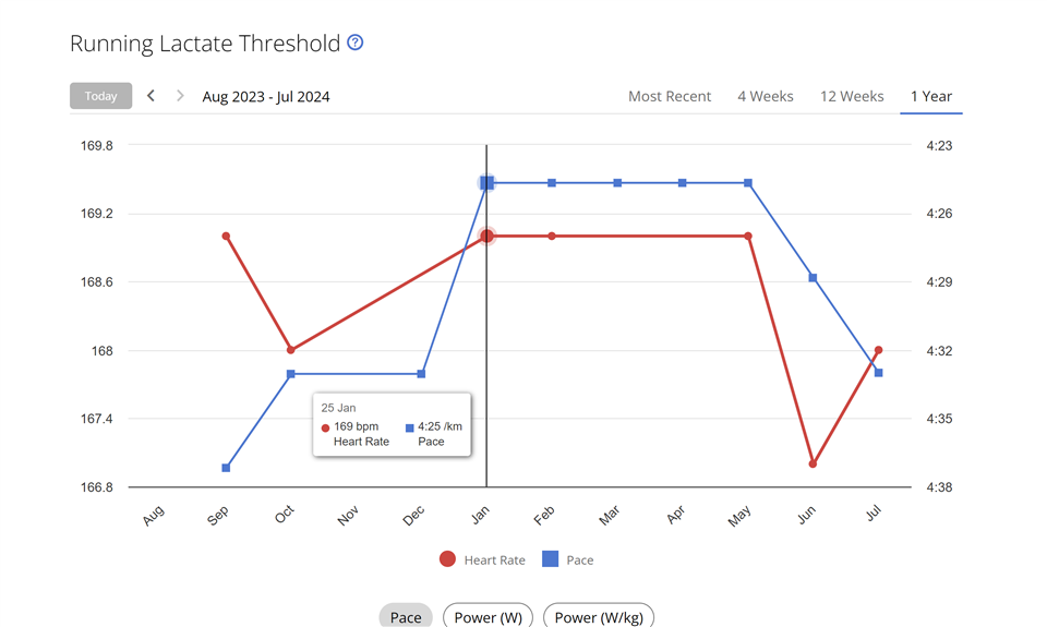

With one of the first "Threshold" suggestions I got a downgrade in my LT pace(from 4:25/km to 4:29/km)...nothing serious but it got measured let's say.
After 2/3 weeks of "Base" and "Recovery" runs due to the training load, that I need to increase gradually, and due to HRV being low, today, I had my "Threshold" suggestion again.
Pace was 4:25/km with the idea to go at 4:30-4:35/km after so many easy runs. Didn't go bad, could have been better but whatever...got another LT downgrade from 4:29/km to 4:33/km.

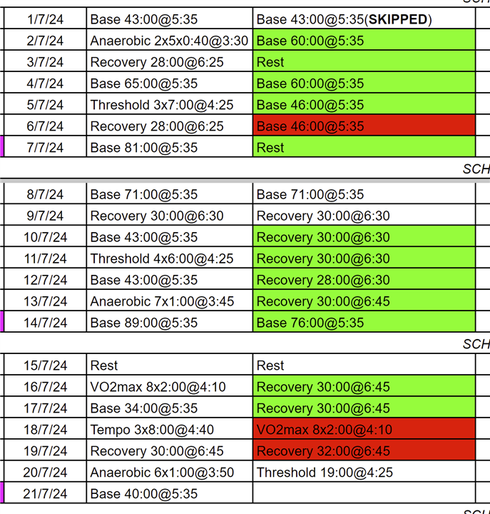

I went to check my next suggestions and I saw that my "Threshold" pace changed from 4/25/km to 4:30/km...was a bit surprised, after the increase in VO2max, but was happy about it because it was going toward a more sustainable effort.
Checked a "Base" run and the pace changed from 5:35/km(stable during the last weeks as you can see from the above table) to 5:45/km Scream
VO2max remained the same, as yesterday, with a target of 4:10/km.
Recovery changed a bit from 6:45/km to 6:50/km.

My LT got an upgrade in December/January when I was back at 0m elevation and I definitely was able to follow the suggestions(high aerobic ones) or stay pretty close to them.
When I went again at 2300m of altitude I was using the target as a reference but the idea has been always to go at around 15 seconds slower and even that was not easy. But no issues in following the Base ones or Anaerobic.
At one point, my Threshold target was 4:10/km without any LT measured so I guess it was following the VO2max fake increase, so what is happening now? Smiley

The table is showing the 7 days schedule of DSW, on the left, and the real workouts that were suggested on the specific day.
