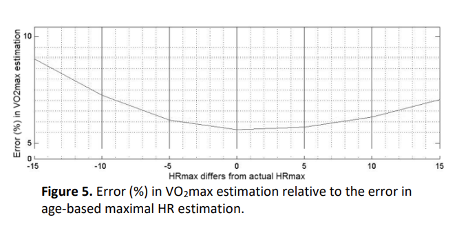

    Not quite yet. The VO2 Max model has an excellent average standard error of 5% or less if your HR Max is right.
    https://assets.firstbeat.com/firstbeat/uploads/2017/06/white_paper_VO2max_30.6.2017.pdf

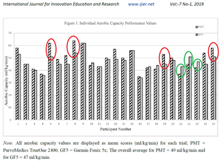

    That said, 5% is the average error. Some people could see a much larger error, maybe as high as 20% on an older Fenix 5
    http://www.muscleoxygentraining.com/2019/05/firstbeat-vo2-estimation-valid-or-voodoo.html
    So, it is possible, but unlikely, that you are very unlucky with an error of 19.5% on your VO2 Max.

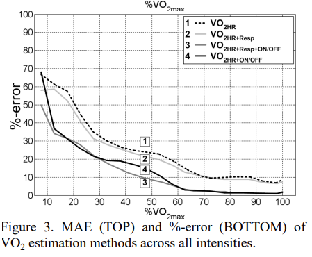

    My training is indeed focused on mostly long easy runs,
    The accuracy increases as HR data closer to HR Max is available See curve # 3 below
    Microsoft Word - VO2_white_paper_Revised_B.doc (firstbeat.com)
     So, it is possible and likely that the combination of having used the wrist HR and a focus on slower runs in the past have biased the data.
