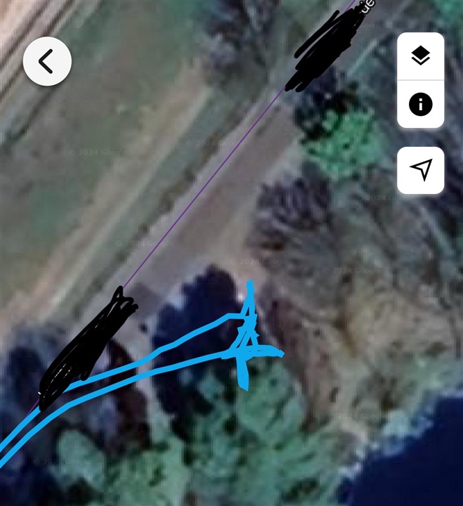

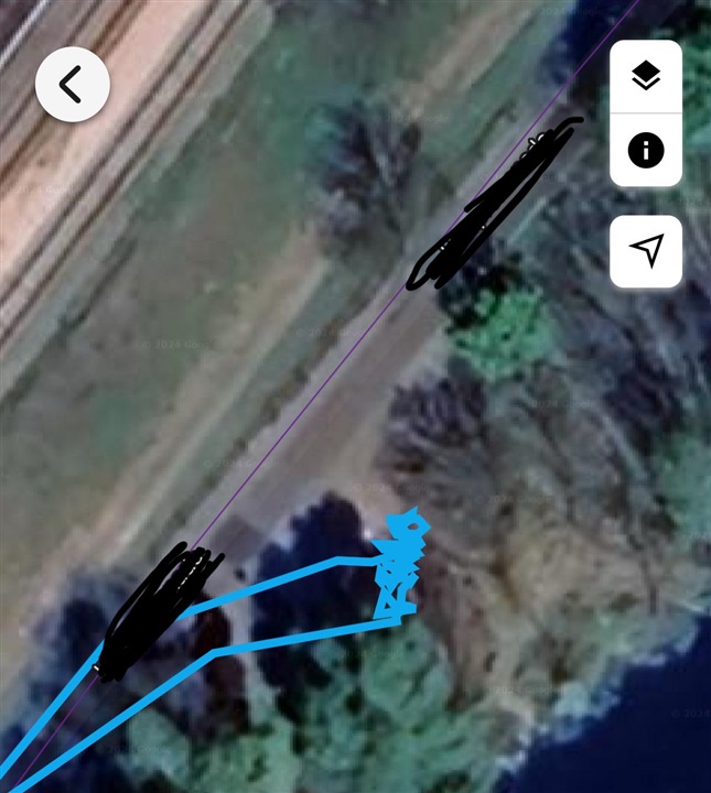

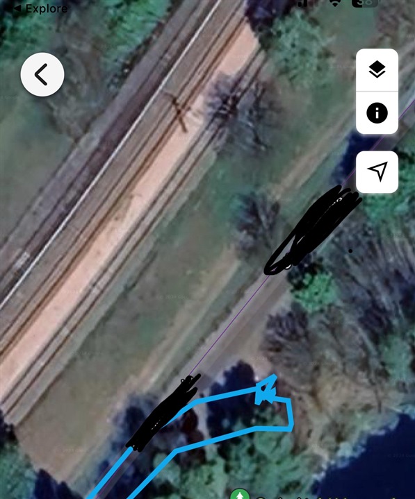

I have made several GPS comparisons between the venu3 and the epix2 and am disappointed with the GPS on the epix2.
Both devices have the best possible GPS settings and have activated data recording every second. The sky was also cloudless.
In some places the GPS on the epix2 jumps back and forth while the GPS on the venu3 records the route correctly. Below are two examples. Garmin, please improve the GPS on the epix2.
epix2:

venu3:
venu3

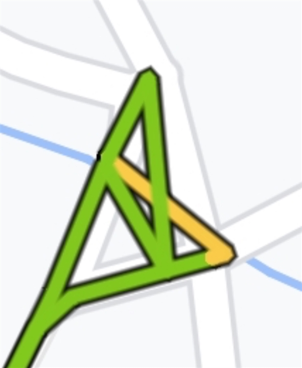

  • To clarify once again, the problem that the thread creator has is NOT  due GPS in my opinion, but is apparently due to the activated "lock on road" setting.
    In contrast to the GPS drift, which is very arbitrary, the screenshot of the thread creator clearly shows that there are clear connections to the roads that the watch is trying to lock on.

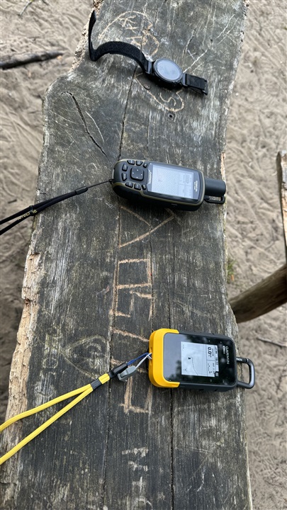

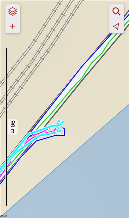

    I did a little "GPS drift" test today.
    Devices :
    tactix 7 pro
    GPSmap 65s
    EtrexSE
    All 3 devices were stationary and next to each other for 1.5 hours (!!)
    Note the scale in the screenshot of the Explore app.The scale is 90 meters =295 feet
    You can also see a railroad track on the left side of the picture for size comparison.
    Note how close together all three track lines are.
    All devices were in the best mode and without auto pause.
    I would like to point out that although I do not own an Epix myself, the tactix 7 is basically identical and has the same GPS chipset as the Epix gen2.
    Personally, I find this comparison of the tactix with the handheld devices very impressive and I can't find any outliers.

  • Turning off the "lock on road" setting helped. Now the gps works as expected. Thank you.
