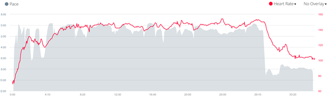

See the heart rate chart inserted. I stopped and resumed the walking activity at around 22mins, and in this case the heart rate started giving the correct readings by jumping up a factor of about 20 bpm-  so frustrating. According to this it really seems like it is a software problem that Garmin has to solve ASAP.

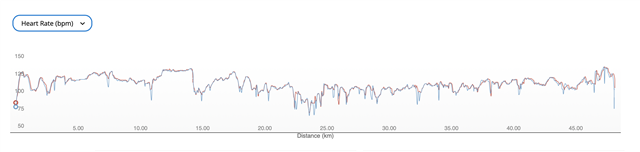

  • Is there anyone who doesn't have this problem?
    Yep. A few of us have reported no problems. This is a comparison between two watches for a bike ride today. One is definitely on WHR and the other connected to a HRM-Pro+. The correlation is that good I had to check! For reference the blue is connected to the strap. The drops in the strap are not uncommon for me and deemed to be physiological. On occasion it's possible to see, although not as large, dips in the WHR at the same point as with the strap.
