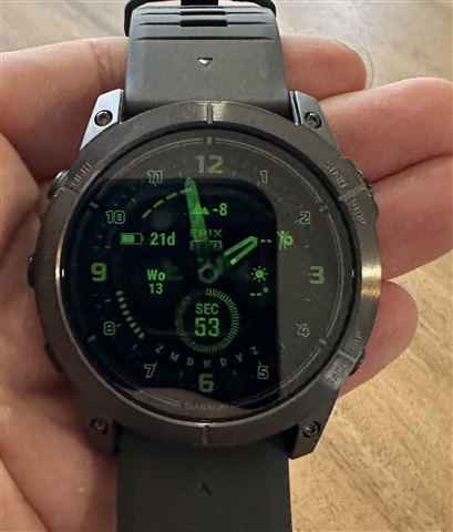

Hi, I just received my new Garmin Epix Pro Sapphire and the screen is green?!
Any suggestion or is this a faulty device?

Is red shift activated with color green? It's now called 'Green Shift' ...

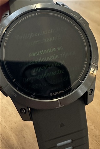

No, its also at boot-up and the screen is distorted as you can see.
It can still be green-shift. I just tested and except for the very first splash screen it is also green during startup if System>Display>General Use>Green Shift == on
First splash is also green and the screen is distorted. Even after a factory reset still the same issue. Came green out of the box and had an barely readable intro to connect to Garmin connect app.
I'll return the watch.
Looks like a malfunction. Contact garmin support.
