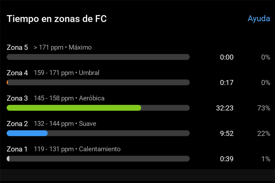

Hi, I have set the heart rate zones based on lactate both in general and specifically in running. The problem I have is that when I finish a workout, the heart rate zones during the activity have the wrong range, not the one I have set in the zones. I've tried setting it up on Garmin Connect and the watch but to no avail, can anyone help me with this please? Thank you.

  • I currently only have the Epix. In Garmin Connect it shows me the same zones as on the watch based on the lactate threshold data but at the end of the activity reviewing the zones, the Z5 always starts at 163 and my threshold is currently 164. It shows me some default areas and not the lactate ones.

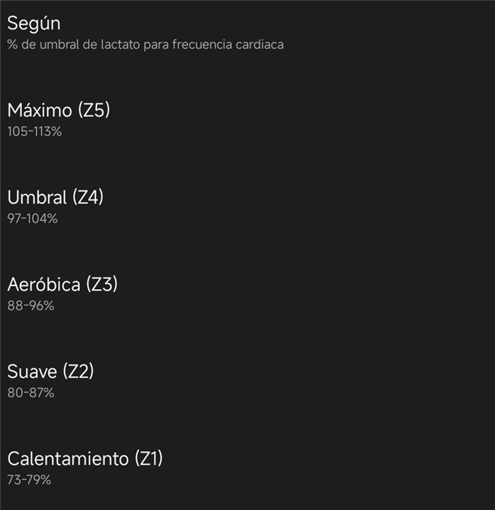

  • I think your values are in fact about correct. By default the zone 5 starts at 100%. So this is that 1bpm that bugs you?
    Is Zone 5 starting at 100% in zones definition?
  • No tiene sentido que con estos % mi Z5 comience en 163. Debería comenzar en 172. My HR Max is 185.
  • There is a bug in Garmin Connect mobile. If you reset the zones, the app will tell you they have been reset, but won't update the screen. You have to go back one level to "hear rate" in the menus and then return to the "zones" in the menus to see the change. I tested this several times changing the zone system, resetting, etc.
    It looks like 163bpm, and you might only see a display bug issue. Does this sound right?
  • After resetting the zones several times and changing the heart rate mode also several times, In today's training it does indicate the range of the zones correctly. I don't know how long this will last. I don't have a lot of confidence in that.
