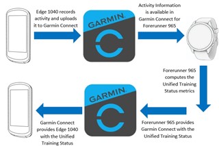

    Possible. While new devices like the Edge 1040 use the Unified Training Status for the exchange of data, older devices use the original Physio TrueUp only. For the UTS to work properly, you have to sync both devices, one after the other, before and after each activity. Often you have to wait a minute after the sync, and then sync both devices again.
    This is a diagram explaining how it works (from the article What is Unified Training Status? | Garmin Customer Support):

  • As I wrote, Edge 830 used a different method for syncing the data between device and GC, hence it is well possible that for some it worked all right earlier, while not as smooth as then, now with newer devices.  However, syncing both devices was necessary with the old method too.

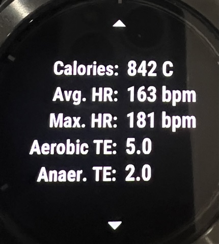

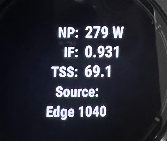

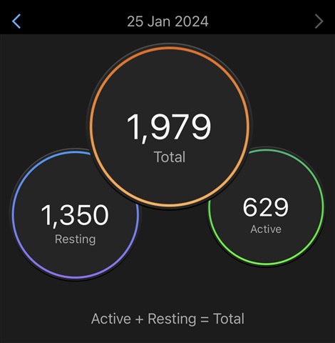

  • From yesterday, recorded ride on Edge 1040 while wearing the Epix also. All metrics synced up by Unified Training Status and same on Epix, Edge and GC.  Images below show the activity is visible on Epix, however the calories burned on the ride (842c) not added onto overall Active Calorie count.  Come to think of it there isn't a total calorie count on the Edge.  So UTS should be doing some adding up in background which is not working??  Looking at HR logged in Epix watch while I was wearing during the activity it was a lot lower, I was not recording the Activity on the Epix.  Has it used this lower HR from Epix for calorie count and ignored the recorded ride on the Edge 1040 with HRM strap?
