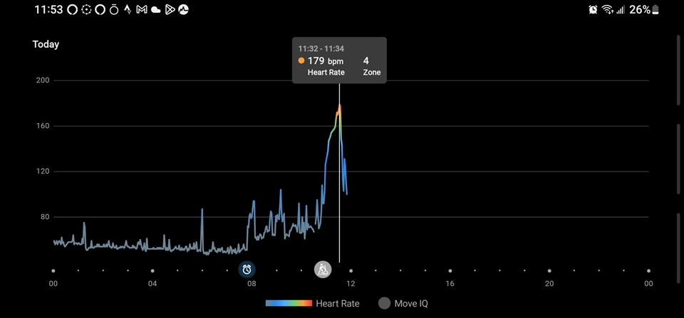

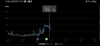

  • Did you open the HR widget and take a look at the last 4 hour chart. I find the the watch face and first page of the widget show a low value but the last 4hr chart shows the correct value along with a correct recorded history.

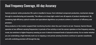

  • The watch HR sensor operates in a low power state when not recording an activity. This is suitable for recording resting heart rate, sitting, strolling etc..
    For more intense activity to be recorded correctly you need to start *recording* the activity. Since you already have, and use, a chest strap it will give you the best result and additional data benefits to pair the strap and record on the watch.

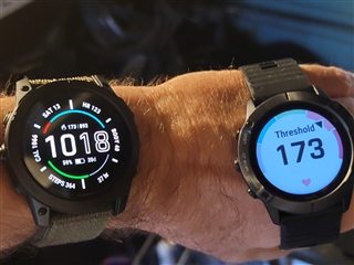

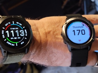

  • Today I did try a test with Zwift, albeit on the treadmill. I used my Fenix 6X to record my run and left my Epix on my wrist displaying the watch face.
    After a bit of heel dragging for the first minute or so the Epix matched my chest strap within +/-2 BPM for the majority of the run, all the way up to 184 BPM max from the chest strap. This is all very encouraging.
    However, during my warm down the watch lagged with my decreasing heart rate by around 10-11 BPM for much of the time. i.e. true HR of perhaps 133 BPM, watch showing 144 BPM.
    As I just walked out my final few steps with my arm raised (not swinging) to observe the HR on the watch face it plummeted to as low as 90 BPM while my chest strap was still showing figures in the 130s. So that was a complete (if not terribly important) failure. Sorry about the woeful photography, but here's an example when I stopped to take the photo and the watch shows 93 BPM while my true HR is 143 BPM. i.e. the watch is not measuring correctly at all.
    On syncing and reviewing the data it seems that Move IQ identified the treadmill effort, which resulted in the good tracking of heart rate. Once my movements did not correspond with "running" (no arm swing) it looks like it lost the plot. I would imagine that inddor cycling makes it rather difficult to identify that there is a recognisable activity taking place, due to limited movement of the wrist and no road shock etc..
