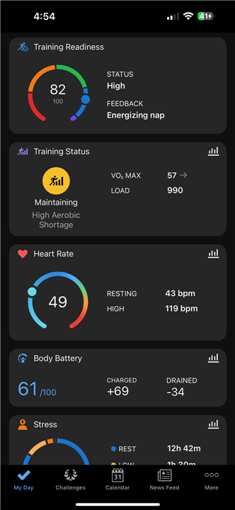

I have a low resting heart rate so anytime I sit down to watch tv or use computer i keep getting NAPS showing up in my timeline.
Please allow us to turn off auto detect on NAPS.
Thanks
Daniel

Unfortunately nap detection is hopeless and seems to use a low resting HR + lack of movement to falsely detect naps. Loads of us when testing the beta commented in the bug trackers.

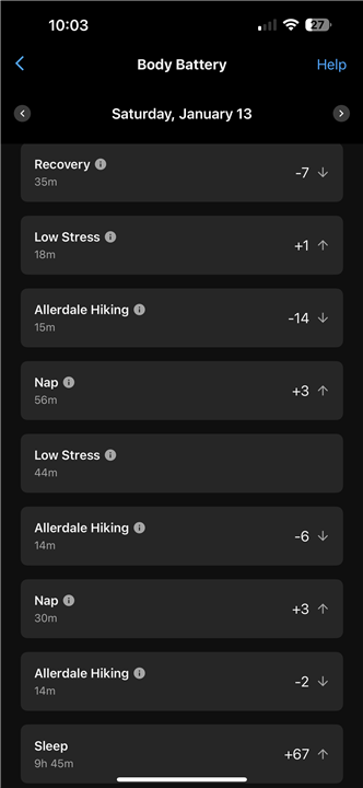

On one hand, false positive for naps have no serious consequence on the watch metrics as long as they are shorter than 3 hours. Below 3 hours, they are just wrongly categorized rest periods. Your recovery, body battery will benefit from these rest periods. Above 3 hours, the watch will replace your previous night of sleep with the new fake nap. If you care about your sleep analysis score data, you will have to change the sleeping hours back to what they were in Garmin Connect. However, I think the training readiness will still be impacted by the change of night sleep after the correction (sleep history and sleep score are baked in and not correctable there).
On the other hand, the only way to defeat the false positives is to disable the wrist HR. I have set up my battery saver mode to no change except the wrist HR and I use it to prevent fake sleep when I remember. The downside is that the watch will not see the rest period at all and will update your recovery/body battery using fixed rates. The other downside is that you have to remember to turn the wrist HR back on when you go to bed (I have set up an alarm to do just that). How far will I go to curate the metrics? :-)

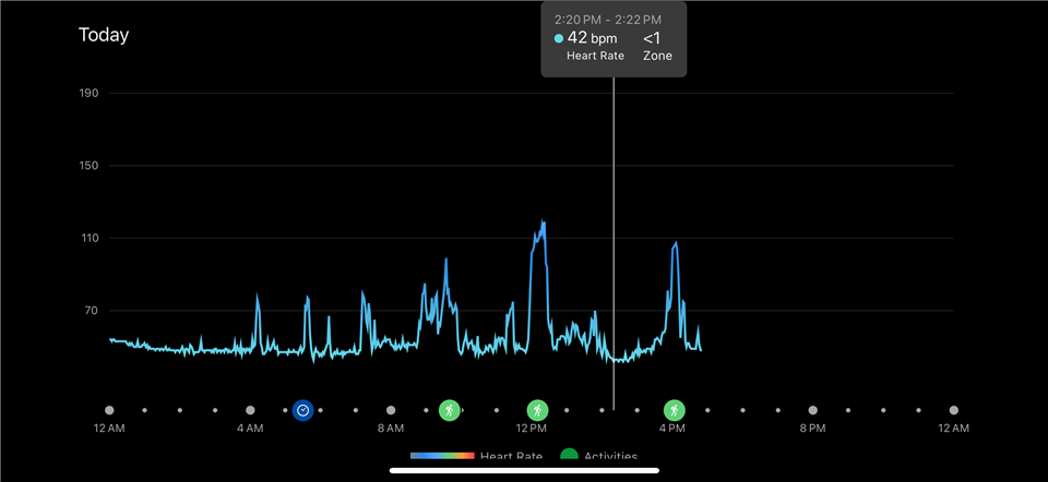

I have a low resting heart rate averages mid to high 40s but I rarely get misreported naps when reading or watching TV. I suspect there’s more than RHR affecting the errors.

if i disable WHR outside activities it seems to not register false naps but then i’m compromising the bodybattery measurements etc. …

i can get several a day, often during work hours too when its obviously impossible Im asleep!
