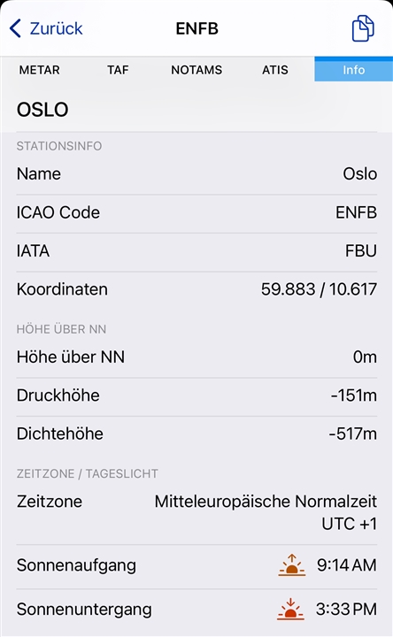

    I have retrieved the current weather data from ENFB, and in my databases the coordinates are still those of Oslo.
    Even if the airport is no longer in operation, the weather station can still be operated.
    It would be very strange if a heliport were to use the ICAO code of a commercial airport.
    EDIT :
    I actually found some contradictory data on the internet. There are pages that identify ENFB as an oil platform and also the weather data is different than the data for OSLO city.

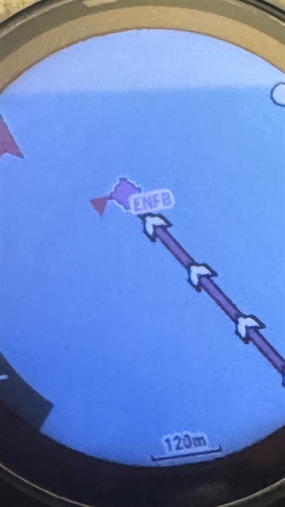

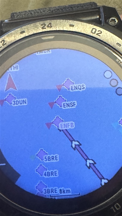

    My watch also says that ENFB is in the middle of the water:
    Since my tactix 7 pro has the latest official aviation database, which is based on data from Jeppesen, I assume that ENFB is indeed the oil platform.
