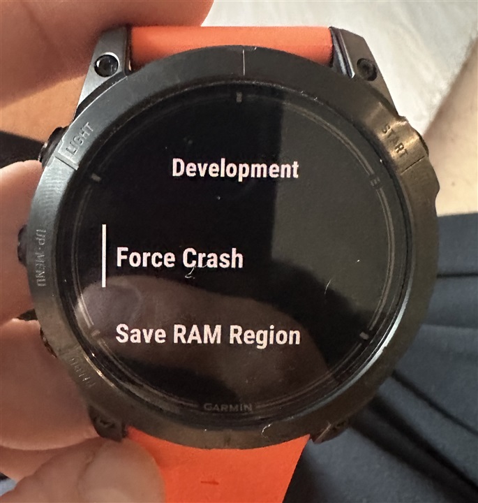

I reset the clock through the developers menu and everything started working
Hi and thanks. Tried that now, and unfortunately nothing changed. Also tried to re-install software through the developers menu but no success.
