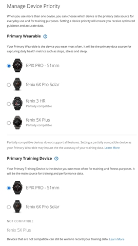

    For example,  I have Epix Pro (since last Friday), 6X Pro Solar, 5X+ and 3HR. Last week, before the Epix arrived, I used my 5X+ whilst my 6X was busy, attached to my Basecamp laptop for map import/processing. While the 5X+ recorded everything as it should, my training load from the activity was a big fat zero. Annoying especially as it was an all out effort on the treadmill.
    If I look at the options for device priority then only the Epix and 6X are fully compatible for training data. 5X+ is not compatible, as I discovered, and 3HR does not warrant a mention. So be careful when buying a "cheap backup device" as it may not satisfy crucial data analysis/accumulation needs beyond the basics.
