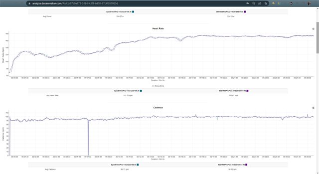

  • I do not think it is a vibration issue and Garmin have not suggested this, and they have the data behind this chart - they tell me this is normal and expected! Which is BS of the highest order of course...
    I think the issue is that Support see an *average* bpm which is within 5 or 6 bpm of the HRM Pro and think it's all fine, but the second by second comparison tells a completely different story. You can see several examples when my HR ramps up the Epix 51mm stays way way low. On some rides results are better but all rides have several examples of this staying far too low trend.

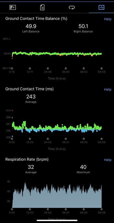

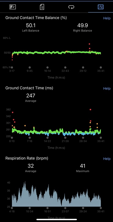

    Running - steady + ramp up
    Running - Intevals
    Clearly as the running results show, its not a hardware issue - it's simply a firmware algorithm issue or more likely some corner case that some of us see - but if you see it, its blatant. I think because even with the 'bad' data the average seems plausible so people with anecdotes saying everything is fine may have it, but fail to see it. Or maybe they do not have it. But for those of us with weeks of data, its super obvious as you can see from the contrast between my running and cycling results.

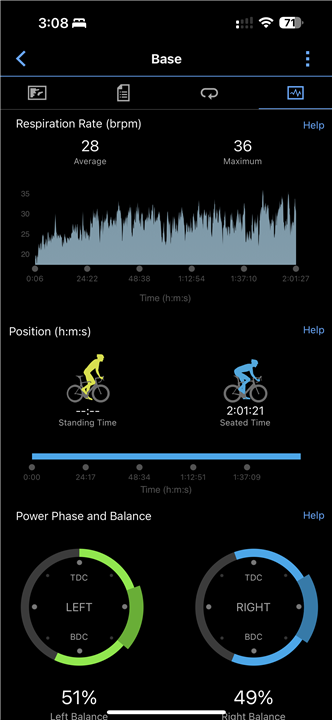

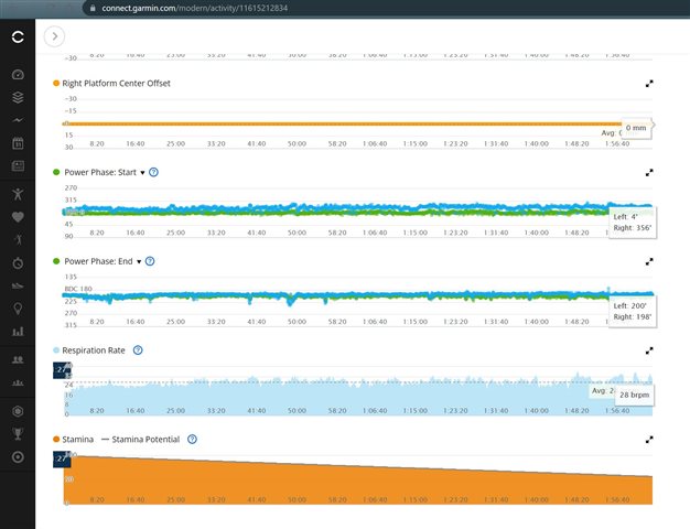

  • do you have gaps in respiration chart with hrm pro plus ?  I rarely have stable full length respiration chart on running activities.  today workout I got the respiration data back but still gaps like bfore
  • I do not seem to have any gaps in respiration data for either running or cycling
  • try look at it in garmin connect website,  sometimes it doesnt show on gcm app
  • Doesn't seem to make a difference - no gaps for me
  • Try keep an eye on it in future sessions. See if drops and cause gap. At rare times I do have full chart.  But mostly have gaps.  Which I suspect is also why I no longer get lactate threshold updates since March
