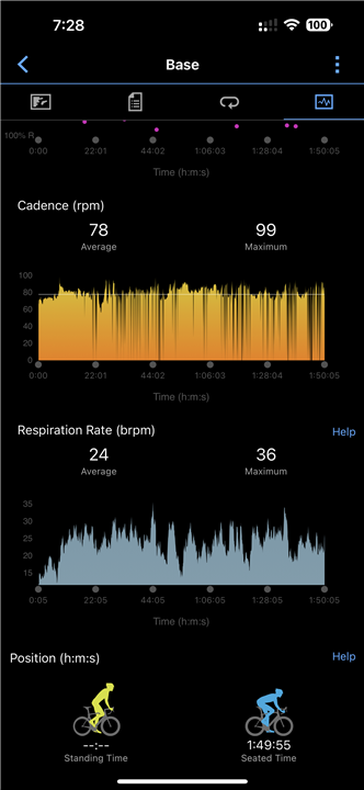

  • Here a short activity -commuting- recorded con the epix. You can see the massive drop on the heart rate.
  • So 11.28 which my Epix Pro shipped with had wrist HR 11.00.03 so it looks like a fairly clear indication 13.22 did do something to wrist HR coinciding with these new reports due the version jump
    FelipeSerra who just posted his HR trace above also sees a very similar instant where things dip for a while like my graph above and it gets stuck in a low HR state.

    Here is another section of my ride yesterday where the Epix Pro is completely out of whack - pay attention to the power graph. This hill sprint was from a standing start and its just WAY too low..in fact it only recovers AFTER my sprint finishes! (power drops to zero again). It's so blatently obvious something is up, the HRM Pro trace is from the purple line. Its too far off for it just to be the lag you see with optical. Something is up - it just gets stuck low with a gradual ramp.
