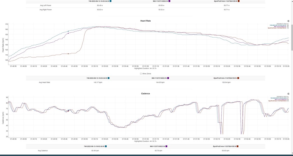

  • I did see a few instance where HR just got stuck bubbling around 100-110 for about 5 minutes vs the 745 connected to the HRM and the 965’s optical - picture is self explanatory
    There were other occasions where it was +/- 10BPM from actual
    This ride was actually far better than most and generally HR was within +/-2 to 3 BPM off from the HRM Pro Plus too.

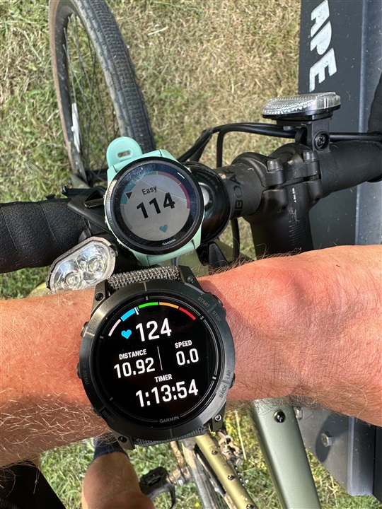

  • Today I did another outdoor run test ,
    245+ hrm pro plus vs epix
    As soon as I start my fast interval ,
    Epic stayed at 90-100 ( even went lower than 90 after few secs ) as if ohr monitor went to sleep or stuck for entire 90 secs fast interval
    While 245 with strap went from 90 to 168+
    So disappointing!! Most important function of the watch ruined by sloppy firmware update ( my guess is firmware 13.22)
