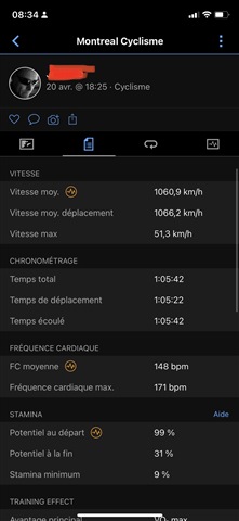

This week I experienced weird data output from the altimeter. First I notice it while skiing and on another day while biking. Altitude is off even while standing still. Pictures and video attached are showing the data output that is oscillating and not accurate: Bike activity on my Epix is showing speed at more that 1000km/h and 20KM ascent. I did a watch resent and still the problem persist this morning as my altitude is below see level as shown on one of the attaches picture.
I’m out of option here. Any ideas? I’ll try to set the satellite to GPS only.

  • I had the same thing happen to me yesterday on a bike ride and after a few feet my EPIX 2 said I had gone 7 miles and was averaging 500 miles per hour.  Looking at the data it has the distance and time recorded correctly, but it shows my elevation as dropping from 217 feet to -1640 feet and staying there.  Does that mean my altitude sensor has failed?
  • If you have done all the troubleshooting noted above and after testing further you repeatedly have the same issue when you record outdoor activities, then it would be a strong likelihood. It is the pattern that helps you make the determination. One-off events if seldom, can be windy days or your clothes interfering with your barometric altimeter port.
  • I did the troubleshooting and just did a walk just now of less than 4 minutes where it reported I covered 43.8 miles at an average speed of 708mph. Looking at the detailed data in the FIT file it shows my elevation as mostly being -1640ft but once it jumped to 45390 feet and then 65617 feet before dropping back to -1640.
