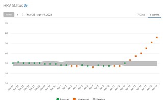

Over the last week or so, my HRV values have nearly doubled. Overnight values have gone into the 50s and 60s. Nothing really has changed in terms of my lifestyle or training.
Here's a screenshot:
Has anyone experienced this kind of change? Thoughts on what it might mean? Could it be an issue with the device?

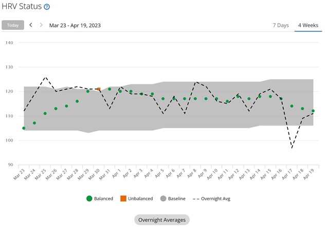

    I have not experienced such a dramatic change - here's my HRV status for the last 4 weeks:
    The one night dip on April 17 was due to a lot of drinking that night - one month after a death in the family...

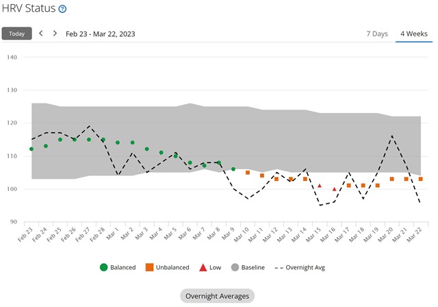

    The preceding 4 weeks look like this:
    Family member's illness, hospitilization and finally death on March 17... Recovery followed.
    So... there were assignable causes for any trend irregularities.  Can you assign no such causes for your trend change?

  • No, nothing. No changes in lifestyle or training as noted in the original post. It doesn't make sense. There's something either underlying physically happening or there's an issue with the device. Has the algo changed?
    I just scrolled through the entire history of readings back to January. There isn't a plot dot over 31 until the change noted in the OP...
