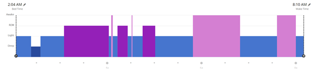

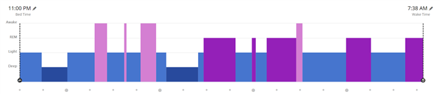

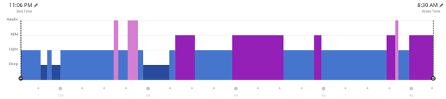

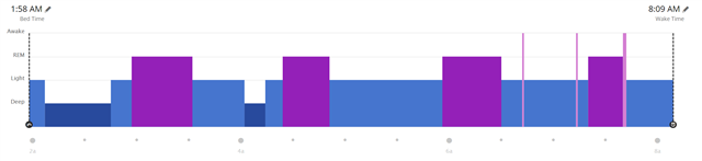

what have you done to the sleep mode? I have been using the Epix daily since back in April. Out of the box, it recognized perfectly when I went to bed and when I woke up. I set my sleep schedule fom 23:00 to 7:30: if I went to bed at 1:00 it would not say that I went to bed at 23:00 but at 1:00. And the same goes for waking up.
Since 11.28 it is just f*cked:
24.02.2023
I went to bed at around 01:40 and not at 23:00.
23.02.2023
Again, not in bed at 23:00 and didn't wake up at 8:30
22.02.2023
Correct! And before the update.....which you guessed it, I did the evening of the 22.02.2023
21.02.2023
Again, correct!
