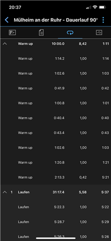

The pace is displayed correctly, but: the timer only runs in slow motion.
After 1km, with a good delay, the first lap is shown per autolap.
The watch says it took me just over 1 min for the first warmup km.
In fact it was 05:30 - 06:00 min.
saving this exercise takes like 10 min and the watch again is very slow.
