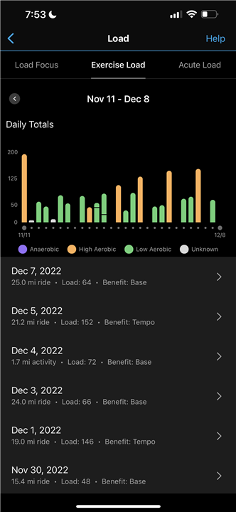

I bought the Epix to  mainly use with my cycling smart trainer. I’m following the Garmin suggested workouts for “Bike Indoor” each day. The suggestions for the past few weeks have been base and tempo, not anaerobic. However “Training Status” says “Anaerobic Shortage” and suggests more anaerobic. For most days my “Training Readiness” is High or Prime. There seems to be a disconnect between the two. What am I missing?

  • So I found that my lactose threshold was set to the same as my max heart rate. Not sure if it's related, but I read that lactose threshold should be about 80 % of max heart rate. I updated this in the watch just now.
    I think the question is how is anaerobic being measured? I probably have something set incorrectly.
  • I think the question is how is anaerobic being measured
    The watch is looking at the duration, intensity and repetition of intervals to determine the contribution from the aerobic and anaerobic systems. The intensity is as a % of VO2 Max pace/power and HR.
    So there is no direct way to predict what the contribution will be. Some long easy runs as well as fast intervals can lead to anaerobic points.
    Additionally, the final label of your workout could indicate a much lower type than your intent. This is because HR is lagging during very short intervals, typical of anaerobic workouts. So don't worry too much about the labels, look at the aerobic/anaerobic contribution

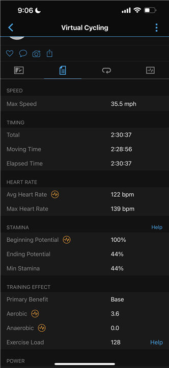

    I did the anaerobic workout above in my photo yesterday and it counted as primary benefit = base, aerobic = 3.3 and anaerobic = 2.0. I think the intervals are too short.
    Today the watch suggested a 2 hour and 30 minute base ride, which I did, and now I'm back in an anaerobic shortage. Obviously, because Garmin suggested base, not anaerobic. If Garmin would suggest anaerobic, which actually resulted in anaerobic, I wouldn't be in a anaerobic shortage. Which seems to be the main issue here.

  • Your anaerobic intervals were at 151% of your FTP which is consistent with anaerobic targets (150% to 215%), so the target was right, and you did train right.
    Because the watch uses mostly HR, you probably didn't spend enough time in the >VO2 Max HR range to get the full anaerobic credit, and the watch gives you more aerobic credit that anaerobic. This happens often. Although the watch must be using more than time in HR zones info, because I can get "sprints" workout to register as "sprints" when I push to the high end of the target interval.
    That said, you got some anaerobic points, and even long base rides can give you additional anaerobic points, so going after the anaerobic shortage doesn't mean doing only anaerobic workouts, thanks Goodness :-)
