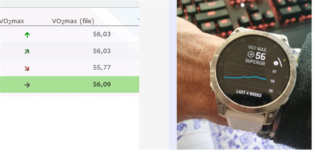

  • Connect your account with runalyze.com, on their web page you will have VO2Max from Garmin with two decimal places.
  • VO2Max from Garmin
    Aren't they rather showing the Effective VO2 Max? Where can I find the Garmin VO2 Max there?

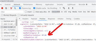

    You can find it for example in the JSON data fed to the VO₂max report of Garmin Connect Web. Not visible directly on the page, but you can access the background data with the help of your browser's DevTools » Network (F12 in Chrome, Edge, Mozzila, etc) - the precise value is stored in one of the XHR streams, under the label "vo2MaxPreciseValue".
    However, taking in account that the claimed accuracy of the VO₂max algorithm is 95% [source], which means more than +/- 2 ml/kg/min at most people, then looking at anything after the decimal point is rather pointless.
  • They show effective VO2Max calculated by their algorythm and in next field in the row VO2Max from Garmin file.
  • Add it to your display via the settings . The small cogwheel next to teh right of the date/ week area., Select VO2 Max (by file)
