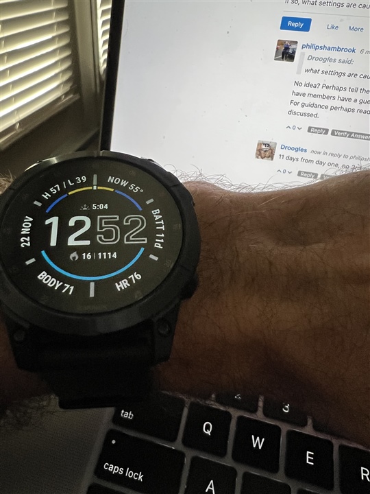

  • For example, after fully charging today. It’s the starting out at 11d that is questionable. Where are people seeing 16d?:

  • This is not about what battery life the watch is achieving. It’s about the projected battery life showing 11 days instead of 16 days. If a person buys a new Epix, doesn’t change any settings other than turning wrist gesture mode on and the always on display off, then when fully charged, if they flip back and forth between pulse ox on and off, they will see 16d, 11d, 16d, 11d …
