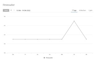

Hi,
since today the calculation of my fintess age is somehow corrupt.
I jumped 4 years overnight and it is recommended that I have at least 3 days a week with 5min of high intensity training.
I actually have 5 days a week with more than 40min per day.
This seems to be a new bug and maybe a Garmin connect problem?

  • Hello,
    thanks for all the advice but that's not all the problem.
    Today my fitness age went back to the original state, literrally overnight.
    I did not do anything different than in the last 24 month. Just my morning workout with 40min Indoor-Cycling and planks and situps.
    It just makes no sense that I have such a hickup while doing what I was doing for month now.
    VO2max is unchanged for weeks now.
    That is why I think it must be a bug. Wether it is in the Epix software or in Garmin Connect.

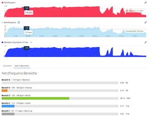

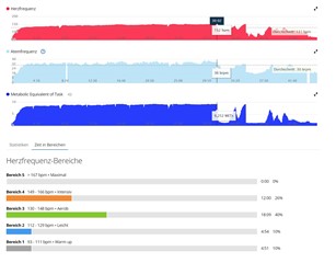

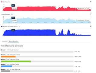

  • And also check these two activities from the week before:
    Friday:
    and Wednesday:
    There were definatly enough Vigorous Intensity Minutes.
  • The 5 Vigorous intensity minutes must be logged within 30 minutes, so it is impossible to tell just from the total IM numbers whether it was really that case or not. They were not necessarily missing yesterday. It could have been also for example on 15th. There must be 3 Vigorous days within the last 7 days.
