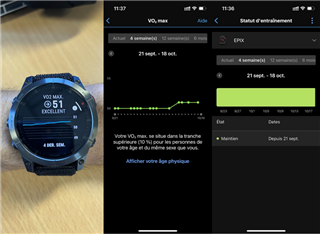

  • I have the same issue. Not really sure it's an issue though... Just curious.
    My VO2max is calculated after each run but it's increasing very slowly. I can see the value in Runalyse grow with 0.01 to 0.05 between each run. As a matter of fact training status has frozen to "maintaining" for the past two months, despite training load inscreasing consistently... And VO2max is also increasing, but too slowly to get a "productive" status.

  • I have the same issue with my Epix 2

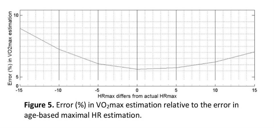

    Now, the watch is using statistical models to give you a VO2Max. For these estimations to be most accurate you need to have a balanced training, including enough VO2/anaerobic workouts so that the watch gets your "pace curve" right (similar to maintaining your Stryd Power curve). Also, make sure your physiological data (HRMax, age, weight) are correct.
