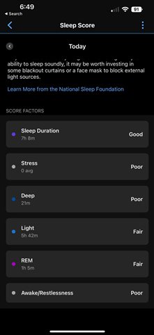

Back to the original topic: Changed browsers and got it to attach. As you can see the Stress is 0. This happens frequently. And I can say with high confidence that if I called Garmin to ask about this, they would have no clue how to resolve it. I'm not piling on Garmin and not creating a 'rant' of a post. It is what it is.

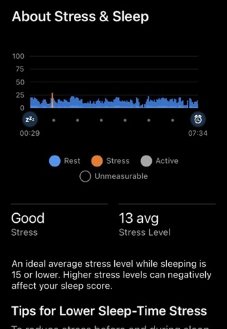

If your stress graph during the sleep looks like the one in the OP, showing only blue values, then it means there was no stress detected during the sleep. Blue values = rest (HRV stress < 25), yellow values = stress (HRV stress > 25). So if that is your case, just like in the OP, then you can stay relaxed - everything if all right with your sleep. It is only the Stress label on the Sleep Score screen, showing 'poor' for no stress, that is wrong.

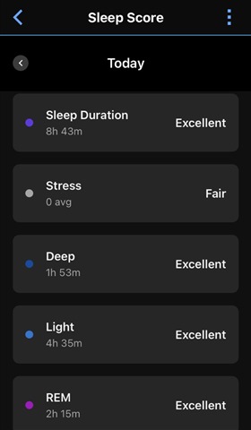

2nd night in a row with NaN average in GC Web and 0 in GC iOS.
Stress level is measured all-right, there are values in there but the average calculation is messed up for some reason.
It does detect it as "fair" but there is no avg. value to it.

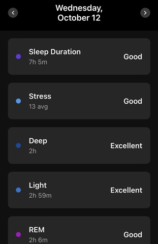

Here is an example from last week, where it tracked the average fine (albeit with a Venu 2):
