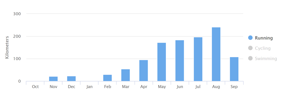

  • You can take a look on my journey...i'm not an expert to give any real opinion but at least you can see the list of workouts done.
    forums.garmin.com/.../general-daily-suggestion-and-training-readiness
  • That was with your half race added as primary race, so the suggestions were built specifically for that half, rather than just generic background fitness suggestions?
  • Yep, that's correct. In the second half of the next week, i should start with the Taper phase.
    Not sure how much the target is affecting the workouts as i'm within the target for a while already but i don't see any decrease of intensity or the length of workouts.
    Generally, i would say that also the previous "daily suggestions" were working pretty well as the increase in load looks fair enough(started to follow them end of April/beginning of May and continued with the race plan when it became available during the first alphas).
    If you have any other questions let me know.
