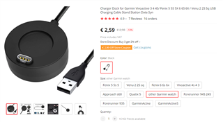

Yes same here. When I got my Epix2 Sapphire first couple of plug-ins it clicked nicely and it seemed secured in place. After couple of times it started to get loose and now I just bump the watch a little bit and it falls out. Pretty annoying if you ask me. I bought a charging cable from Aliexpress like this one:
and I must say it click is and holds way better than the one that came with my watch. Too bad Garmin doesn't produce a cable with this style cause I would buy it without a problem.
