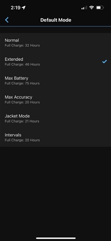

  • I can give you my settings if you like. I am getting battery estimates of 60h and you should have no trouble with a 100 mile race.  I had a course loaded as well with waypoint markers.  I had my inReach connected and iPhone connected but no HR.  With the HRMPro strap I am getting estimates of ~50h battery life. Why I chose the Epix, display is great and the battery is good enough.  This has been tested in ~15h of trail running so far.
  • Wow. I’d be interested in as many settings as you can provide. I feel like I have everything turned off except GPS that can be turned off and am not seeing anywhere close to those estimates. Thx!
  • I also have everything off in a "max battery" power profile except GPS (including OHR off), min brightness in display settings and gesture mode in display settings. I cant get power manger to give me anything over 33 hours.
  • Don't trust Power Manager numbers. I've done some long runs to test and then assess actual battery life from the fit file in DCR Analyzer. Here are my settings and data for 15h run
  • Just attempted to duplicate your settings, still get a max of 33 hours in power manager. Those power manager numbers of yours look similar to a Fenix 7!
