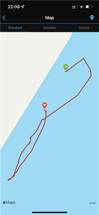

i recorded an open water swim today.  A couple of laps in the sea following some cones.   When I finished, it seemed to record the distance ok but the track is basically a short line.
any idea? I used 1 second recording and all systems multi gps.

  • Thanks for this, but it seems like good practice advise rather than don’t.  My old tracks from 945, as posted are all fine.  The Epix literally tracks nothing. My watch was out of the water quite a bit so something should record.  The GPS even finds a signal indoors on the Epix so I’m surprised it never saw the sky in 20 mins in the sea.   I don’t expect better than the older devices, but the Epix tracks 0. That had to be a bug.
  • My old tracks from 945, as posted are all fine.
    Looking at the track you've posted it appears far from fine. While it might be deemed acceptable do the results accurately show distance, pace and track for your breaststroke swims? How have you verified the accuracy of the recorded data? The chip and the software has changed in the Epix so very likely you'll get a different result. I would suggest you repeat the swim with the watch under a swim cap or towed behind you in a float bag.

  • Yes, far from perfect, but not missing in action.  I’m not sure why you seem so intent on pointing our user error when the facts show the Epix is hopeless vs previous generations for open water swimming.  I tried crawl today.  Same issue.  Anyway, I’ll stop commenting on this as it’s going in circles.  Just tested the 945 from my partner.  Loads better.
