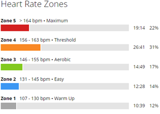

    See below for example from today, zones are dynamic based on LTHR of 164.

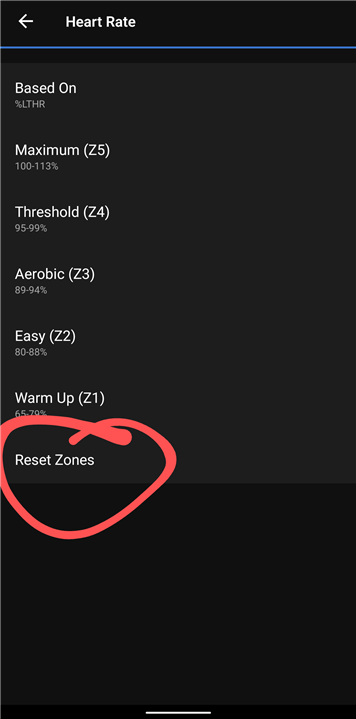

  • Not sure if this is the normal behaviour but i found the issue.
    After changing from "% max HR" to "% LTHR" i had to click on "reset zones" to make it effective.
    I was thinking that "reset zones" was for resetting them to something default. Also because when i change the setting from the phone...the change is showing also on the watch(for example now i tried to do the reverse and i put back on "%max HR" and the same setting is shown also on the watch but if i start an activity, the zones are based on "%LTHR").
