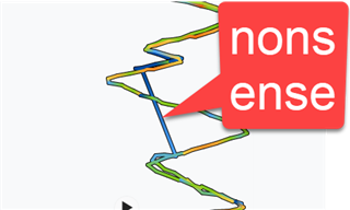

    Max pace is basically a formula based off distance and time. So if distance is out/wrong i.e. track loses connection and puts you off actual track, then yes it would give you incorrect max pace.
    Had issues like that in the past on different watches, some suunto, some wear os and even on my older garmins on the odd occasion when a bad GPS fix has given me a very unrealistic fix. Once had one that so bad (think it was one of my wear os watches - that it had my max run pace at around 3m/km (so somehow I managed to run at 20km/hr along the tracked route - yeah right I believe you watch).
    Would check your track to see where it went wonky. Probably easiest in the connect web, as you have the 3 charts with the map above and if you hover over the spike/drop in pace it will show you the position on the map, so you can then zoom into that area to see if you can spot a reason for the wonky pace.
