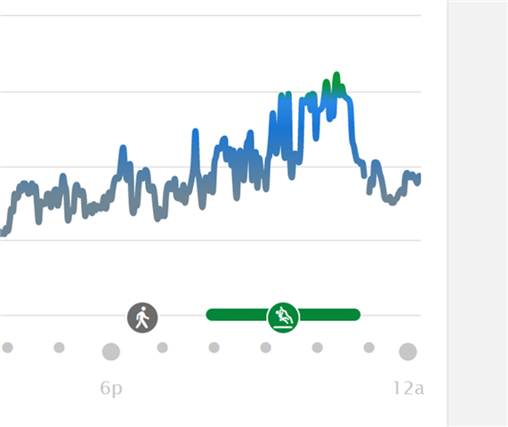

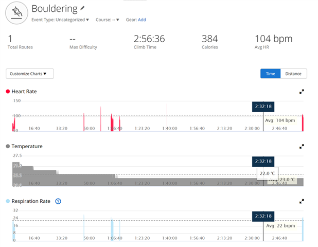

    Here, have a look at the following picture. This is the activity (YOUR fit file) without syncing HRM data. As you can see, strangely, some time points show heart rate data although the watch was in the locker. My theory is that these are times where I was close enough to the watch for it to get connected to the strap (Especially at the start and at the end of the workout and I think I walked to the locker twice to get a drink).

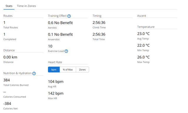

    And these are other data from the activity:
    The "funny" thing is that these data do not change after syncing HRM and watch, how could that be?

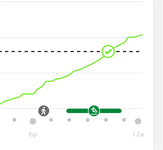

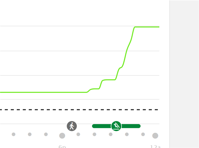

    And even more surprising, if you look at my daily timeline of heart rate, steps, intensity minutes the data seem correct as you can see here:
    Heart rate
    Steps
    Intensity minutes

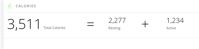

    And even the calories for yesterday show something plausible although the activity itself does not. Besides the activity I probably had around 200 active cals, so the activity should show something in the ballpark of 1250 cals (~1000 active + ~250 resting) and not 384

    Maybe it has something to do with my movement pattern? I locked the watch into a locker, only wearing the HR strap and after roughly 1hr 5 mins I returned to the locker to take a sip from a shake, that's when I see a heart rate in the corrupted data, maybe because the watch was close enough to the HR strap and recorded some HR data on the watch directly.
