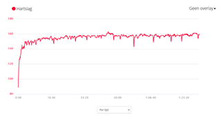

This problem is even worse and makes the watch useless to me. On the very first day, I recorded an 18-km run and the heart rate was just fine:

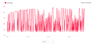

However, since then I have recorded 8 more runs, and they all look like this:
I have also recorded 7 walks, all looking like this:
Obiously, the recorded heart rate jumps up and down below the actual heart rate and a lower value. I also observe this jumping up and down when I am at rest, between lower values of 55-60 (my actual heart rate) and values around 73-80.
As a result, the heart rates reported during a run are unreliable, and also many other metrics are affected: stress level, body battery, recommended recovery time, sleep detection, and probably more.

  • Your cadence looks as bad as your HR. You have those straight lines as well as data points above them. Something definitely isn't right. Would suggest rebooting watch if you haven't already done that. If that fails then a hard reset. If that fails then a system reset (will of course wipe or your settings so you may want to back them up if you have defined screen layouts etc that you don't want to lose.
