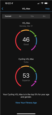

Garmin actually calculates a different VO2Max for cycling vs running (or walking). For example, my cycling VO2Max is 53 but my running is only 46 (which makes sense because I've been cycling for 1.5 yrs and only running for 1 month). In the app, if you select Training Status / VO2 Max, it will show them both (and each will get updated as it gets a new reading from its respective activity).
Yes, but if you get a VO2Max after a Walking activity it is the Running (or general VO2Max). For cycling it requires a power meter. VO2 is stored in the cycling activity without a power meter but it will be the same as your current Running (general VO2).
