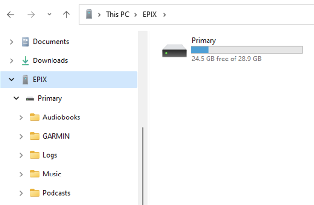

    This is what I see in WIndows 11:
    As noted, no drive letter just the name of the device.

    Also: with newer Windows versions the watch won't appear as 'usb device' (after detection) but as an 'MTP device' which you will see in Explorer as a separate device (without a drive letter)
