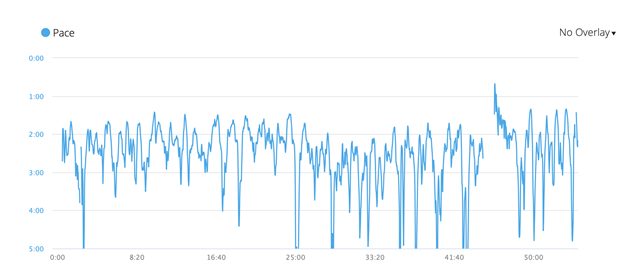

  • Have you had a better result? Another data point and useful comparison (I believe anyway). This graph from my Epix this morning shows just how well the watch recorded the swim with minimal fluctuations in pace:
    compared to an Instinct 2 which was all over the place.
    The Instinct recorded 120m further over the ~2000m course compared to the Epix.
