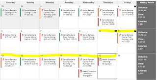

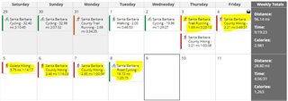

Real life battery consumption seems to be accurate for the Epix. I am going to add on a 7th activity shortly (1hr hike) and today is Day 6 since new and fully charged around mid-day last Thursday. My settings are AOD, gestures for activities but not general use and GPS set to All Satellites. Sleep settings are the schedule the watch arrived with. Shown below is battery status today, morning of day 6 and my Calander of Activities. According to the hour estimates I should have battery till maybe 4am tomorrow day 7.

  • Added a 7th activity of 45 minutes. 13 hours of smartwatch time left on the clock. for 6+ days of use. If I shut AOD off for general use it bumps up the battery for another 2 days.

  • This is a one-week update, after a full charge at 6:30am last thursday, and this week Disabling AOD for General Activities and using Gesture. I used about 8 hours of activity time using All Satellites. Nothing else changed. I have 6 days left of smartphone life. Appears like 1/4 of time is reduced with my daily activities, so should have another 3-4 days before the battery is depleted. So far very happy using the Epix set as it is. AOD disabled with gestures works just fine for checking time and glances.
