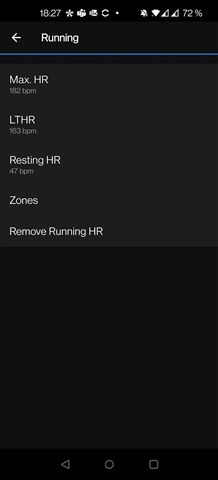

    Before the run I did the following:
    1. Made sure Garmin Connect Mobile and Epix2 was in sync.
    2. Deleted the app cache data and stored data.
    3. Opened Garmin Connect Mobile and logged in with my Garmin account.
    4. Opened my device settings for HR Zones and verified the generic settings.
    5. Opened "Add Sport Heart Rate"
    6. Was surprised to still see Running there but I opened Running and clicked "Removed Running HR".
    7. Exit all way out and verified that the watch synced.
    Still there is a Running HR Zone setting and the Epix2 uses that Zone.

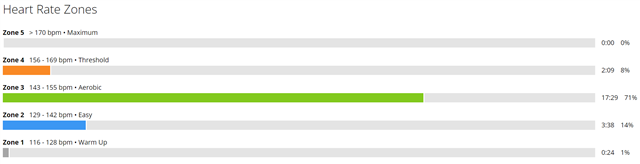

  • Are you saying you can get the HR zones to represent correctly in the data fields during your run?  I want my zones to be based on %LTHR but I can't get it happening.  The zones during my run are always based on Max HR (or something similar).
    After the run one of the data fields shows my zones correctly.  But the other data field doesn't show it correctly.  See pics.
    Correct zonesincorrect zones
