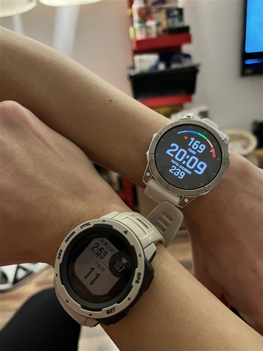

i got my epix 4days,after last day update,some issue founded on it.
1,over high heart rate,when i do some rope jumping in cardio mode,the heart rate sensor shows that over 180,that's not possible for me,the instinct on other wrist shows around 100 in same mode.
then i put some indoor row training,the HR almost same on both watches.
2,frequently disconnected from my iPhone(iPhone13mini IOS15.2.1),the bluetooth range seems limited on this update,the disconnect happens around 7 meters away from my phone.its not happened in past firmware.
firmware is 7.2. Chinese silver version
should i exchange it or wait the next firmware,very confused

  • Garmin recommend wearing watches with optical heart rate above the wrist bone for best results. From your photos it looks like the watches are on the wrist bone thereby making a good reading difficult - https://support.garmin.com/en-US/?faq=xQwjQjzUew4BF1GYcusE59. The link also explains some of the inherent limitations of optical heart rate. These have been well discussed ever since the first watches with optical heart rate were released some years back. First thing to do is to wear the watch clear of the wrist bone and tighten it a notch or two tighter than when you are rest.

  • Sounds like your instinct is not detecting HR well. That looks like a non solar instinct to me the HR sensor on them is quite a few years old now and not as good as the two new generations above it.
    100hr is very low for jump rope!!
  • You have a VERY small wrist.  You probably are getting a lot of jigglle with a heavier watch. Wear it higher up on your arm or get a lighter, smaller watch.  The Black Sapphire one is the lightest and it doesn't have any wiggle for me, whilst the AW7 was heavier and wiggled.  But, I never had WHR issues with the AW.
